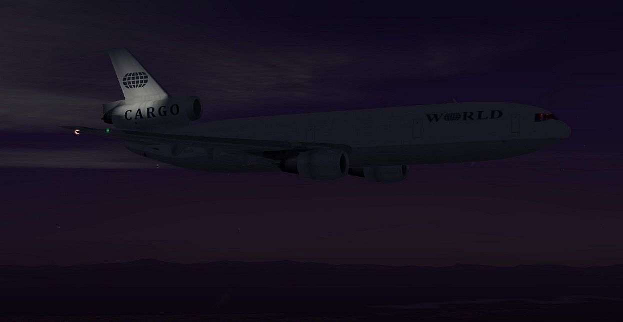

Here we are in cruise over the Pacific heading from Manila to Tokyo.
